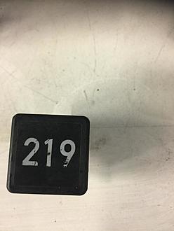

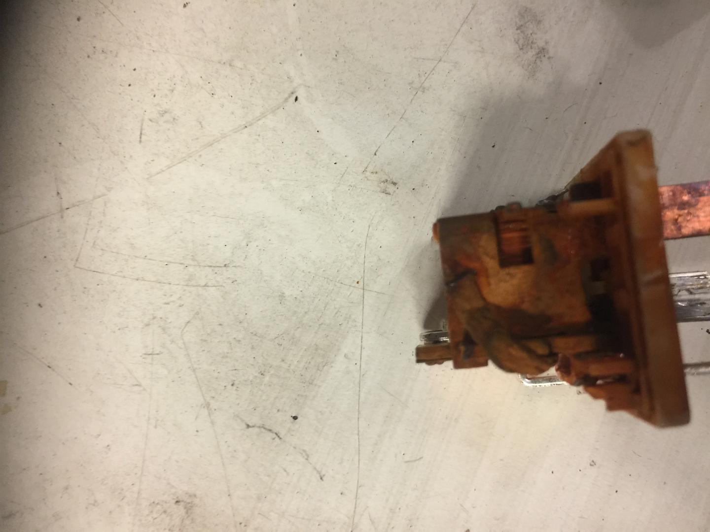

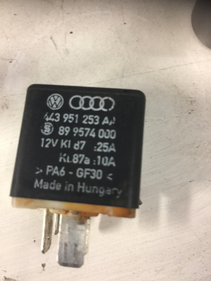

    Olisiko tuo Click image for larger version
ID:	1920441 Click image for larger version
ID:	1920442 Click image for larger version
